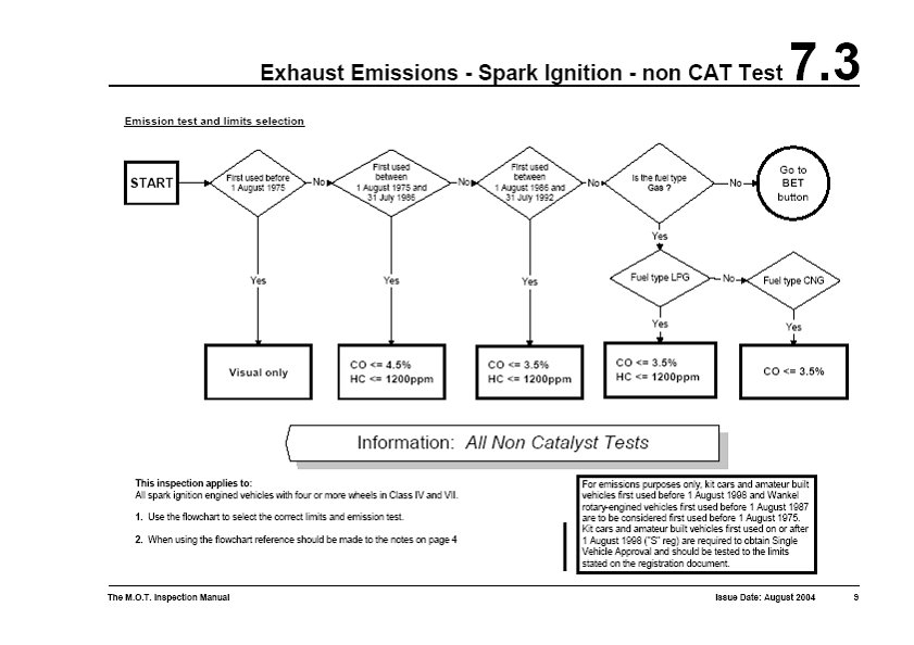

This is the page he needs to study.
Emmisions Flow Chart
The highlighted box, down to the right-hand side is the main instruction about testing kit cars. The bit that we’re interested in says:
For emissions purposes only. Kit cars and amateur built vehicles first used before 1 August 1998,  are to be considered first used before 1 August 1975”
Now if your kit car was not SVA’d then it was probably given an “age-related numberplate” and this should both show on your Log-book as the date of registration, and more importantly, it should show on the Testers, Test sheet, as “Date first used
This is the date that applies for the emissions test, not the date that the kit itself was registered.
Providing this “Date first used” was before 1 August 1998, then it has to be considered first used before 1 August 1975, which if you look at the first diamond on the chart, is Visual smoke only.
“Q” plates, not gone through SVA,  unfortunately I believe have to be tested on the date of kit registration, as there will be no “First used” date. (UNLESS IT SAYS DIFFERENT ON THE LOGBOOK! As my Jeep, said 1971, although a 1987 registered kit)
I can’t stress enough, that MOT stations who are not used to testing kit cars will probably not get it right, so if you believe that yours is only “visual” and he wants to actually test it, then ask to see the test sheet, look for the “first used” date, not the date of registration (they are both on there!)
