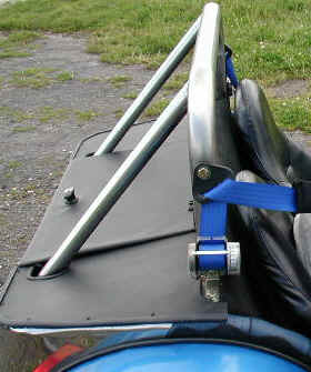

| How to fix inertia reel type seat belts, Note that where the bolt goes through the roll over bar, must be sleeved with a welded in tube. you can't just drill through the bar alone.
IVA compliant. (Photo is of Paul Hanlon's car.) |
