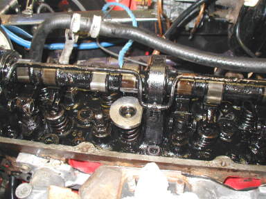

No 1& 2 cam ‘lobs’ are upwards, (away from the tappet follower) slacken the locknut, and screw the tappet adjuster in as far as you can, until you can lift off the follower.
Now with a torch or hand lamp, turn the engine until you see the piston coming up to just under the spark plug hole, then with a smallish screwdriver, stuff as much rope / cord onto the top of the piston as you can. Carry on turning the engine to bring the piston up to the top, where it will ‘lock’ against the rope.

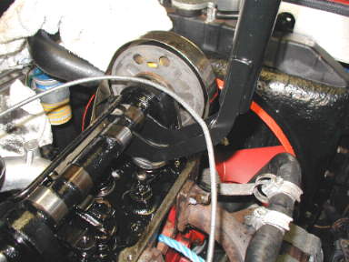

Place the collar on top of the spring cup, and with the special tool that I’ve had made, lever down to release the valve collets, a magnetic ‘pen’ is handy here to get the collets.
Lift off the valve spring etc. remove the old valve seal with pliers, and fit a new one, press it down hard to make it seat, I found a 7/16AF socket just the job.
Replace the valve spring etc. lever the lot down again, and put the collets back in.
