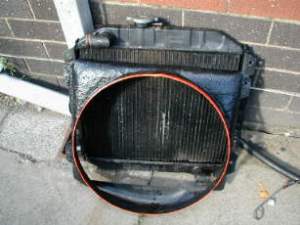

For the monocoque cars, the supplied radiator was a Cortina single row one, I changed it to a double row one, and still keeping the viscous engine fan, made a fibreglass cowl to fit. This proved effective, and was passed on to another member when I went to the Vauxhall engine. |
| Wishbone 2B.
